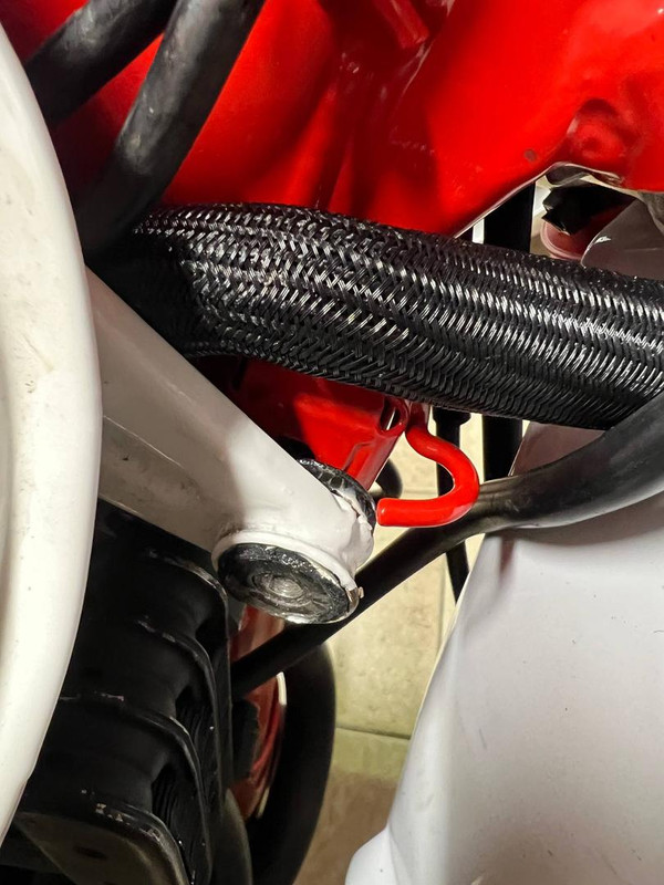

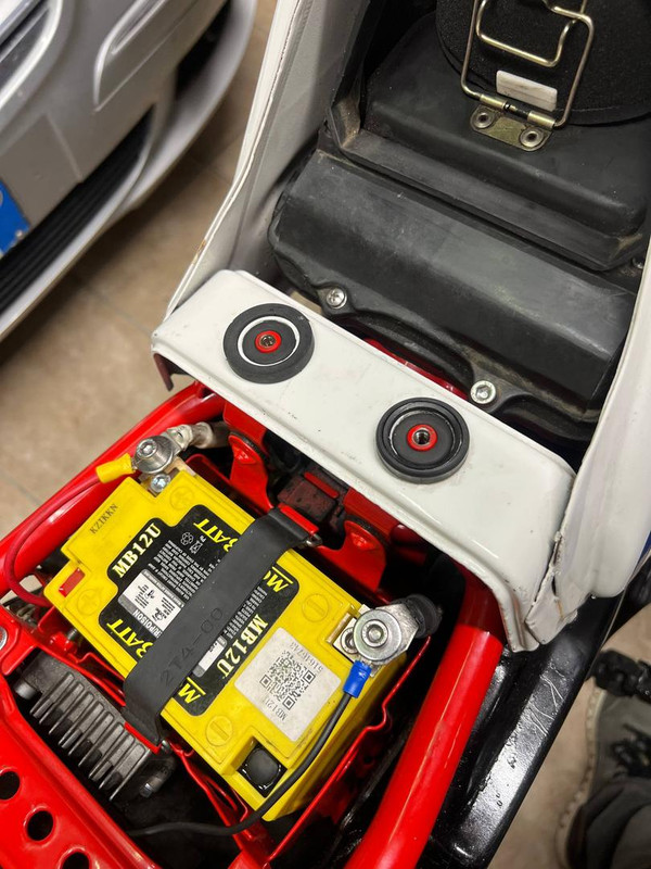

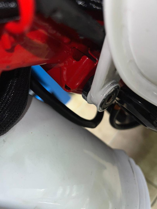

Hi everyone,
Ever since I bought my Tenere, I had this huge gap between the top of the seat and the fuel tank, which bothers me a lot.
I always thought that the gap was caused by the tank being dented or warped out of shape and then some bodyshop tried to fix it, messing it up even more, then body-filling and painting on the messed sheetmetal, because many of the "sharp" body lines of my tank are gone even though the paintjob and decals are perfect.
So, I had a guy that didn't really care about the precise fitment of the seat and said that he was down to swapping tanks. His bike has never been in a crash or any kind of accident, it just needs a paintjob.
Well, yesterday I tried to install this guy's tank on my bike and the bolt holes don't line up, by something like 3 or 4mm
pics for reference
It's as if the tank is too long for the frame? Trust me I tried in every way and order, but I always end up with at least 1 bolt being too much out of alignment with its hole.
Could this mean that my frame is bent?

I wouldn’t jump to conclusions. Seat is more likely to be distorted. Was there anything preventing the seat settling properly above the battery? Sometimes if had to refit it after it not lining up first time.
Without the seat, the tank gets caught sometimes on shite in the way, and needs a bit of a wriggle.
If without cables and rubber pads etc (and airbox) it doesn’t line up, only then would I look at adjusting anything on the tank or frame.
Try it without rubber mounts to see how central or not the holes line up.

It suggests that the bracket on the frame holding the rear of the tank is too far forward, but how on earth wouldthat happen...?
I'd be looking to try a 3rd tank to confirm.
There's no way the other guy would know all the history of his tank unless he had it from new.

This bit is not right.

I have had similar on one of my 1vj. I removed the spacer on the front bushes, started the threads on those front mounts and then pushed the tank forward until rear mounts dropped in. Seems ok.

I initially thought it was the seat, but I also tried swapping seat with the other guy bike, and my seat on his bike with his tank won't leave any gap. So there's that.
I fit and refit the seat many times as well whenever I take it off, making sure all notches snap into their places
