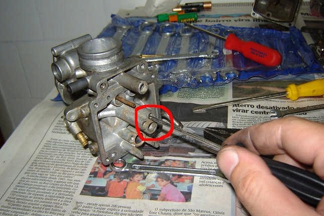

I should add, Fig 42 is what its called in the carb tutorial but i thinks its the same in the carb fiche? am i right?
Here is a pic from the carb tutorial he is referring to, called the pilot jet.

Re: Carb tutorial 1993 Tenere 3 AJ
Post by scottieh »
42 is the fuel screw since it has the o-ring and retention spring. It is turned out 1.5-3.5 turns from bottom. 39 is the pilot screw and it goes in all the way. 39 is what the picture is pointing at.

scottieh wrote: Sat Mar 28, 2020 6:10 am 42 is the fuel screw since it has the o-ring and retention spring. It is turned out 1.5-3.5 turns from bottom. 39 is the pilot screw and it goes in all the way. 39 is what the picture is pointing at.
Cheers Scottie, it's been years since i last played with a carb, 2.5 turns out seemed to be the one i did back then? :scratch:
Post by scottieh »
Mezo wrote: Sat Mar 28, 2020 7:01 am Cheers Scottie, it's been years since i last played with a carb, 2.5 turns out seemed to be the one i did back then? :scratch:
2.5 turns out is what I usually start mine with and then go from there. Currently sitting at 2400 meters elevation. Good luck! :tenere:
Post by Buchtucker »
Thanks everybody for your answers!
Yes I backed it out 3 turns for now, and then we see how it goes.
