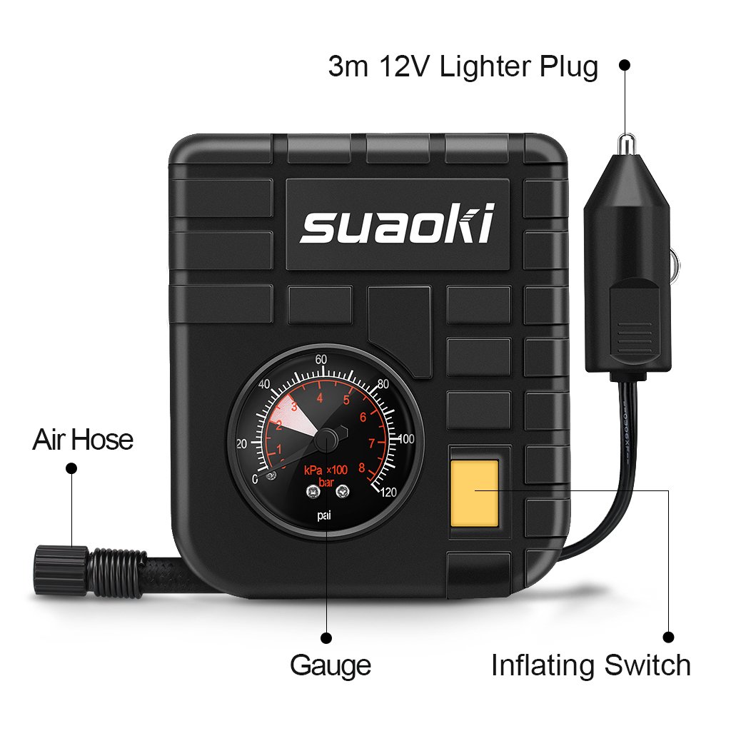

Nice one guys, its mutch appreciated. motorang I heard about someone writing off a bike with like 4ks on the clock because they tightened the chain too much and jumping the bike. it's been on my mind after every speed bump, I'll have a test in a bit. I found this adjustable spanner when I was wandering around town http://www.bahco.com/en/p/side-nut-adju ... -59-c0-67/ I haven't used it yet but I'm pretty impressed with the design there's like 8th to a 10th of a mm play in the moving jaw bit, a little part of me wants to believe that this thing won't round every single bolt it touches.
I'm thinking about getting one of those 12v tire pumps like this one
part of the lure is that I can pump up my air mattress. have any of you had any experience with these? the reviews on a lot of them say the pressure guage isn't reliable.
part of the lure is that I can pump up my air mattress. have any of you had any experience with these? the reviews on a lot of them say the pressure guage isn't reliable.-

Hi,
this is a good pump for tyres, low volume and high pressure, and this is where a gauge makes sense. You will definitely ruin your air matress if you pump a long as you see no movement at the gauge :-).
The air matress is designed to be inflated with lung power, which is about 0.1 to 0.25 bar. So you can use the pump and your hand to feel the hardness of the matress. If you use the compressor to long the matress will balloon
For a classic air matress it will take several very noisy minutes to pump up. For a laminated foam matress (Therm-a-Rest and the like) it will go faster due to the smaller volume.
Special pumps for matresses or boats work the other way round: low pressure and high volume flow, more like a fan than like a pump.
