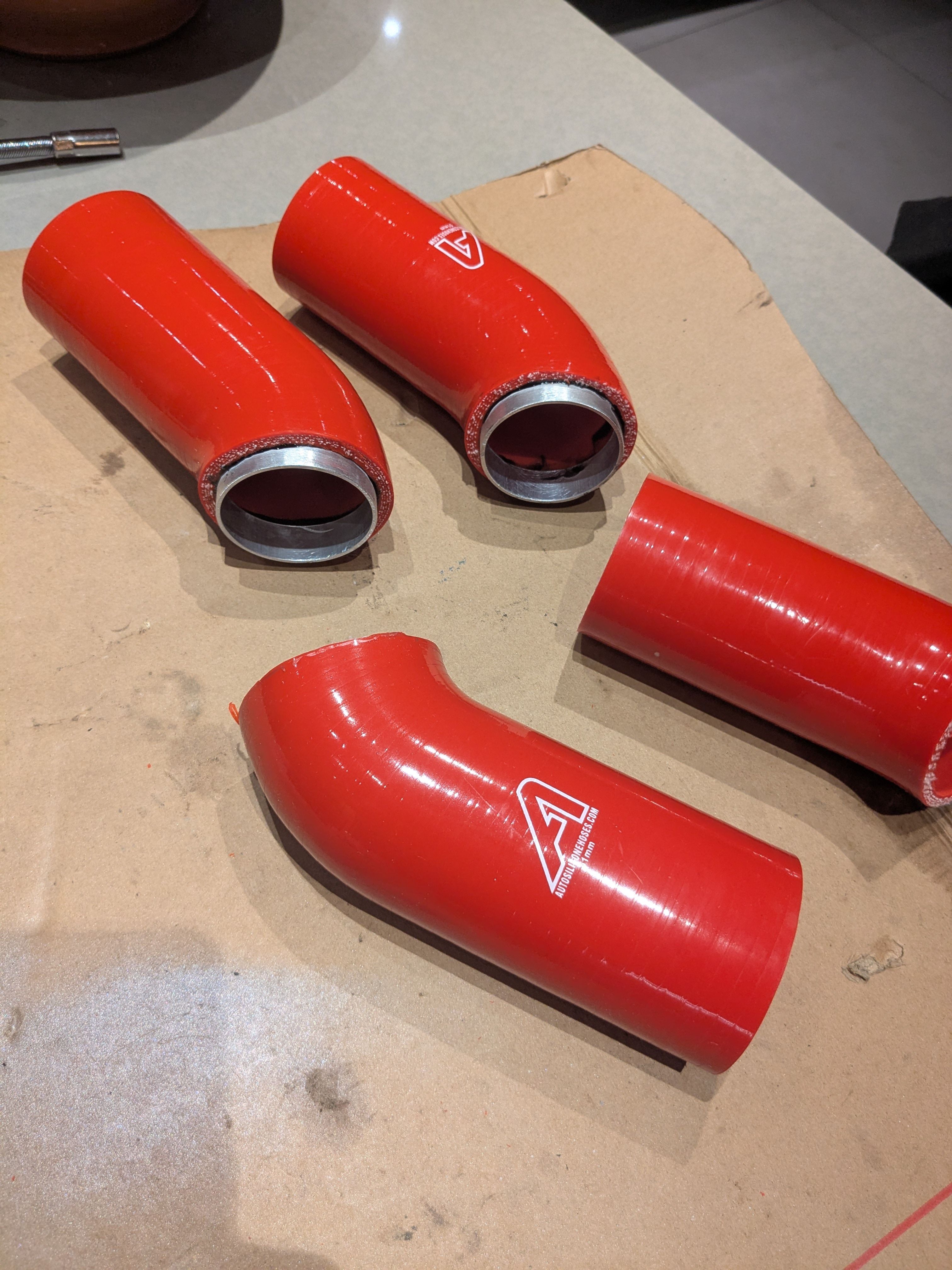

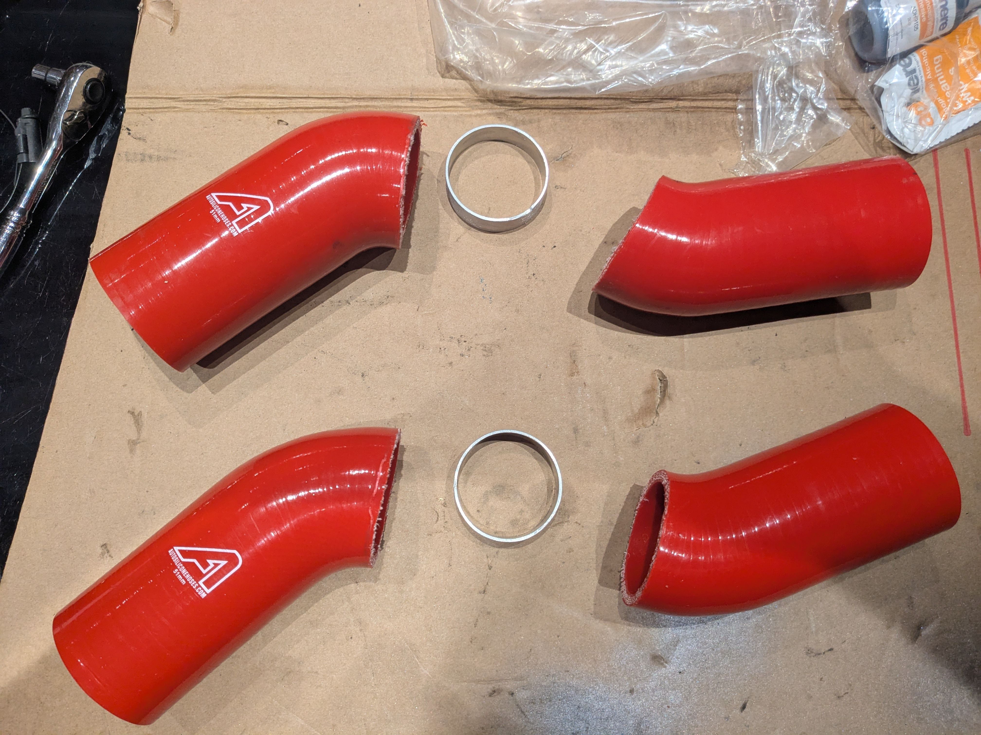

The airbox is chopped in half, and two intake runners made from silicone tube and aluminium pipe. A flexible black cyanoacrylate glue is compatible. (Chopping the intake box maintains battery holder, all original fixing points, mud protection for the rear tyre. You only lose maybe 2 inches of water clearance but who's fording that deep regularly....?)
Pod filters on the end.

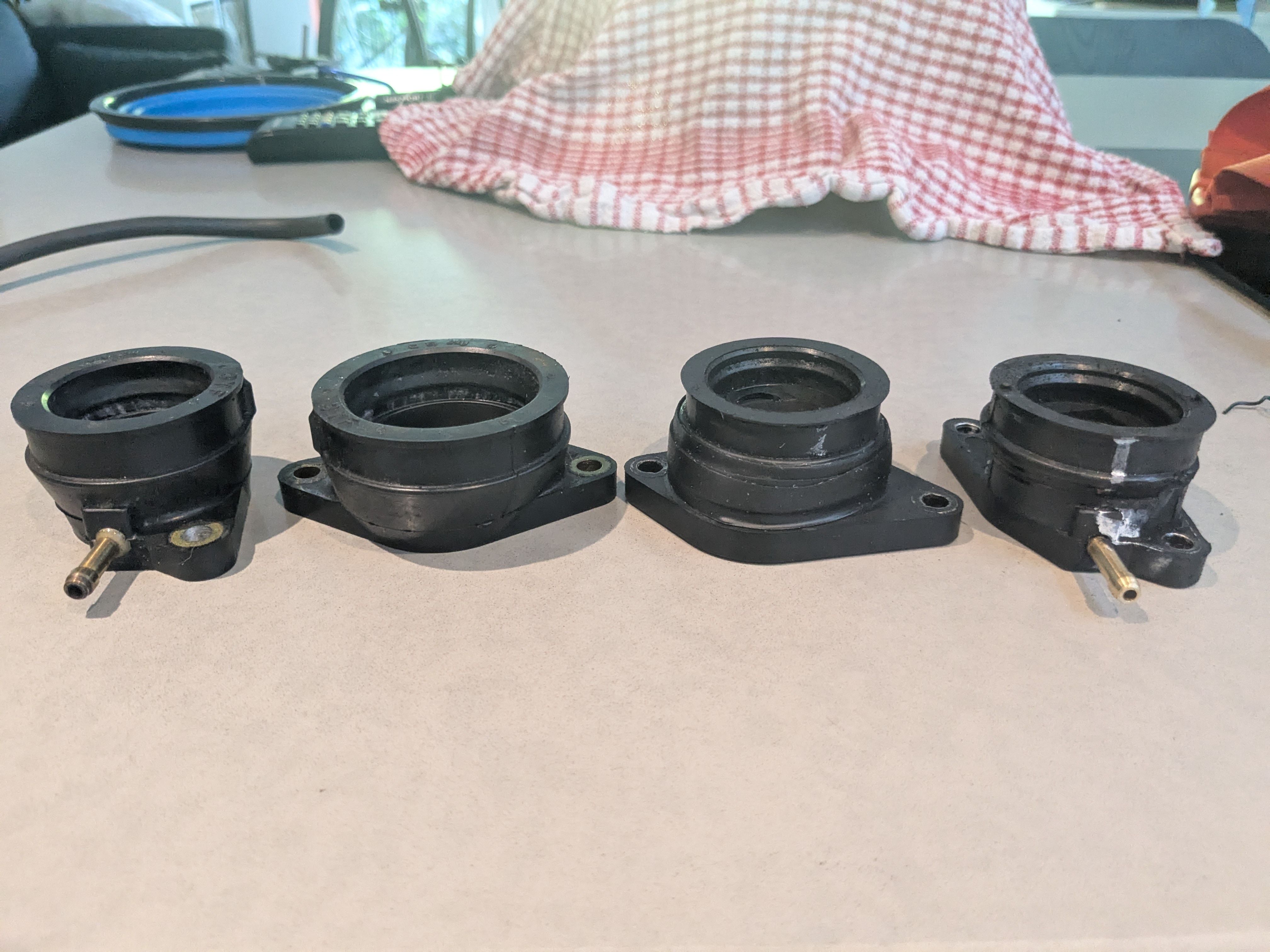

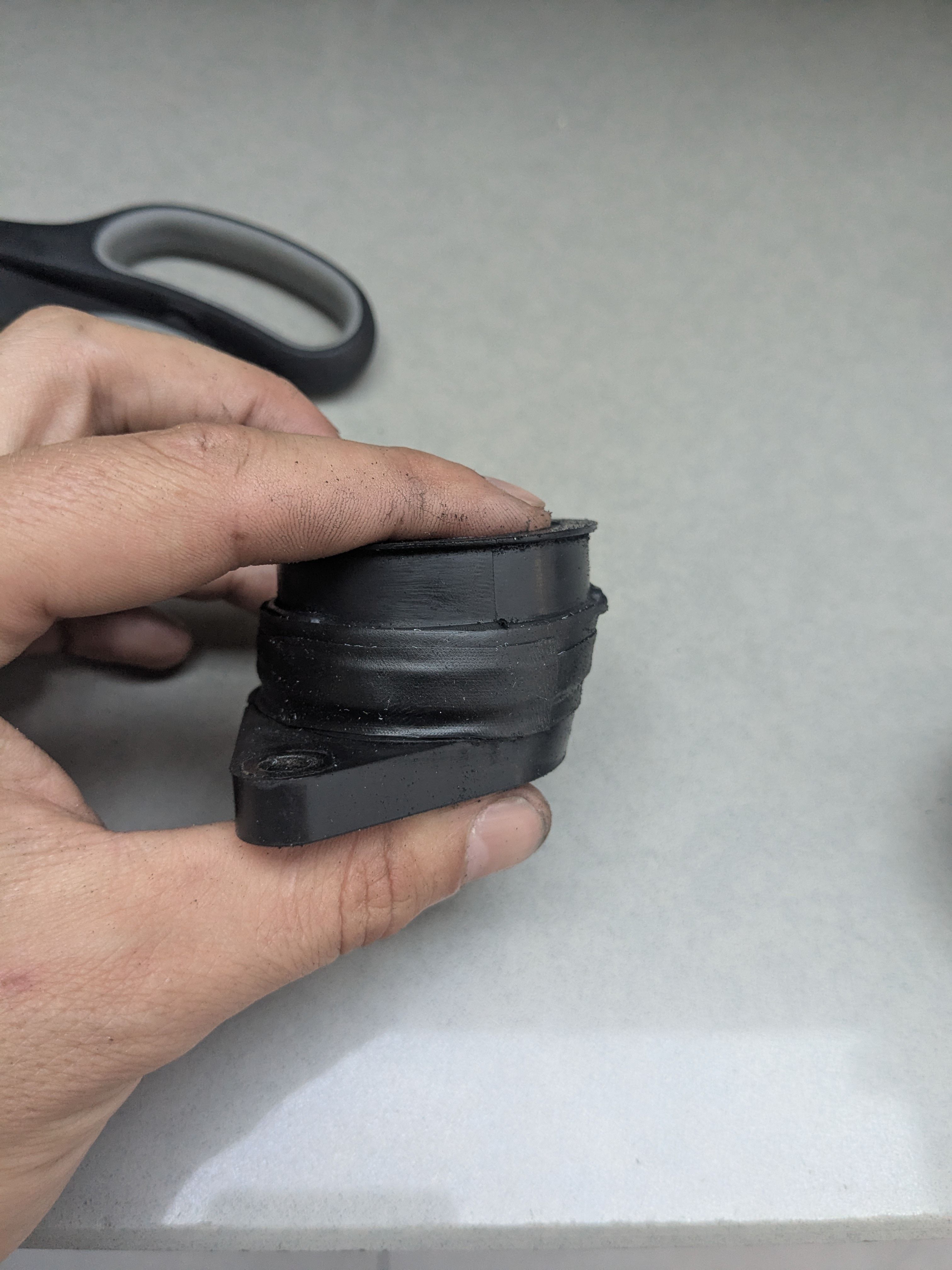

I used intake boots from a raptor but cut and shut to change their angle and make then shorter. Wrapped in vulcanising tape just in case. This way the carbs sit nicely in the frame and they point roughly horizontally rearwards.
