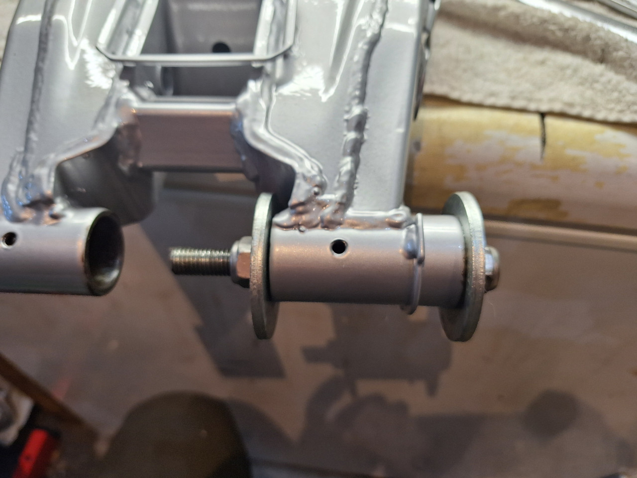

What tool did you use to remove the old bearings and bushings? I am closer to getting mine ready for powdercoat, but I haven't bought any bearing removal tools so far.

cadno wrote: Wed Feb 25, 2026 1:10 pm
Here I have a very handy tool to seat the needle bearings without undue force.
They're not the best welds on these 80's bikes are they?
To remove the bearings,I can't remember the exact sizes, but I used the same method as the above with a 20mm socket to push them out, into a 30mm socket on the outside (roughly, it could have been an 18mm). Or you can just use a punch and an hammer, at least you can for the plastic bushes.

I have been searching online for a good quality bearing puller set. Turns out a good Kukko set is 840 euro... I guess I am also going to use some sockets or I'll make some adapters myself.

LaurensR65GS wrote: Fri Mar 27, 2026 8:50 pm What tool did you use to remove the old bearings and bushings? I am closer to getting mine ready for powdercoat, but I haven't bought any bearing removal tools so far.
You can just drift them out. Be gentle with the bush if you want to reuse it. Although you should budget for replacement.
Or use a cheap socket and extension on the bushes and bearings.

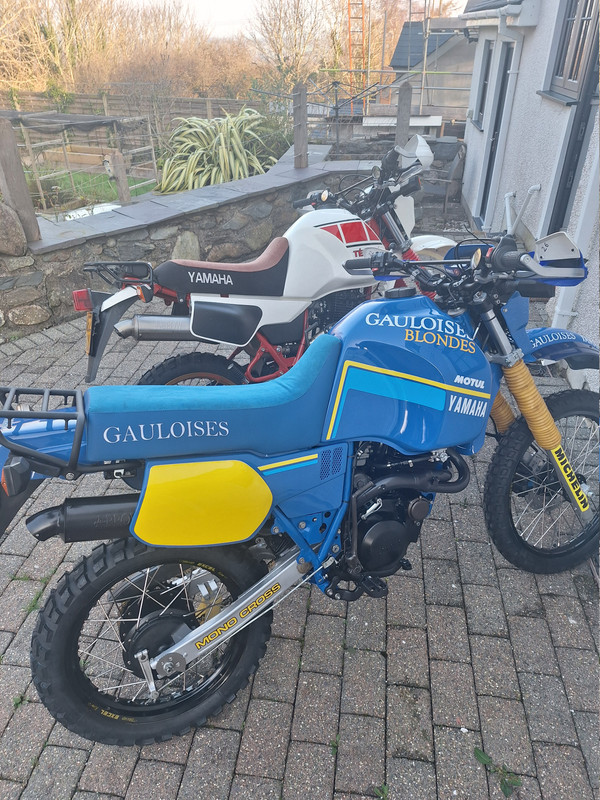

Good to get them outside.
Now she's outside the fork gaiters look awful. I've got a couple of sets of new ones. Whichever matches the paintwork best needs to get fitted :bigeek:
