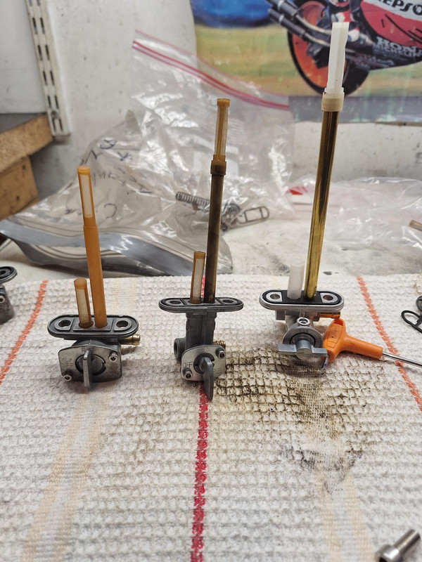

cadno wrote: Sun Jan 19, 2025 9:31 pm So here we have some petcock types.
Starting from the right that's a KTM part that fits.
Middle is what I think is the correct original 1VJ tap, its a little longer and drops the lever lower. Making it easier to use whilst riding.
Left is what I think is off a later Tenere probably 3AJ?
going back to the correct fuel tap question..... neither of those are correct,
This is what I was thinking when I recalled the correct 1VJ one - you'll see the slight drop revealing a number - maybe a batch number? Incidentally there was no reserve on the 1VJ RHS tap.
the 3AJ is higher up, no room for the number.
