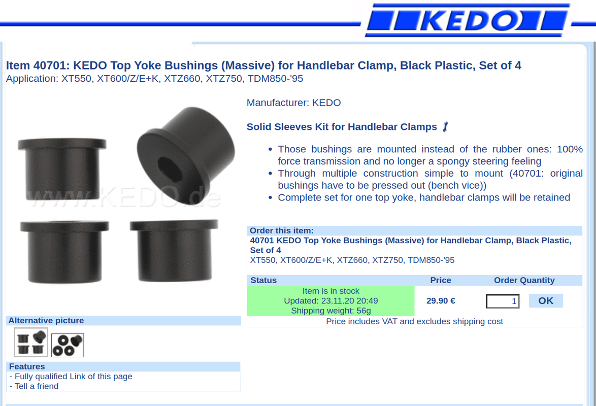

The wheels got a couple of new sprockets, so that's nice. Fitted the wheels under the bike and when I tried to move the bike I noticed that there was a slight movement in the handlebar. After a bit of invastigating I found that the left damper was loose. I could move it by hand. It's not really noticeable when riding.
Is this something I shouldn't be riding with? And if not, do I need to replace the part, or is there a (cheaper) fix?

Kedo sell solid bush replacements. https://kedo.de/products/40701.html
