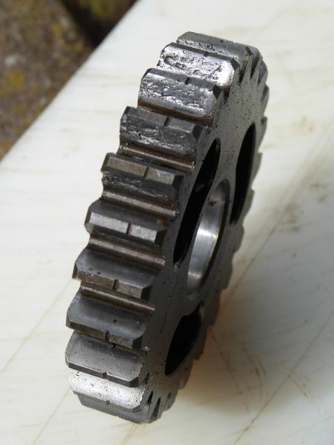

welshlamb wrote: Tue May 07, 2019 8:43 pm well I think I know where this would have been headed :flogging:
When Kev Thomas took my engine apart this is what he found. Apparently NOS 5th gears are just about EXTINCT now (mine came from USA!) so need to treat this baby right , regular oil, no chugging in gears etc!!
Hi
Kedo has them
http://kedo.de/link/50024_gb.html
http://kedo.de/link/50065_gb.html

motorang wrote: Thu Jun 27, 2019 12:12 pm
Hi
Kedo has them
you can use this gear from xte 4mw, i use it for years on my tenere just machined it to the right size, it's easier to find from xte
Hi
Kedo has them
Don't put that back in your gearbox Andy :omg:
