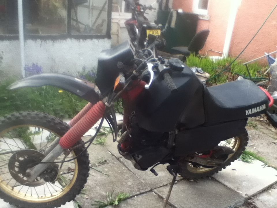

this is what it started out as...
Image]
absolute wreck, shouldn't have bought it really. Shockingly it had an MOT :bigeek:

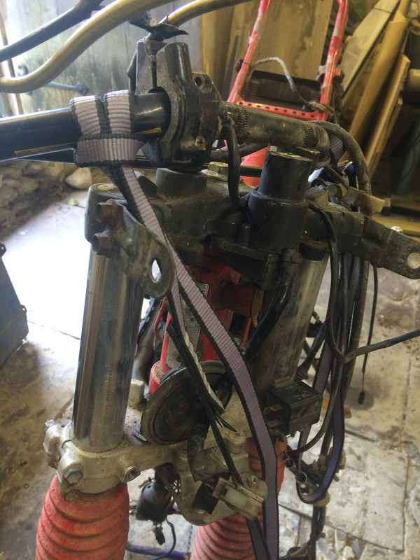

minging front end

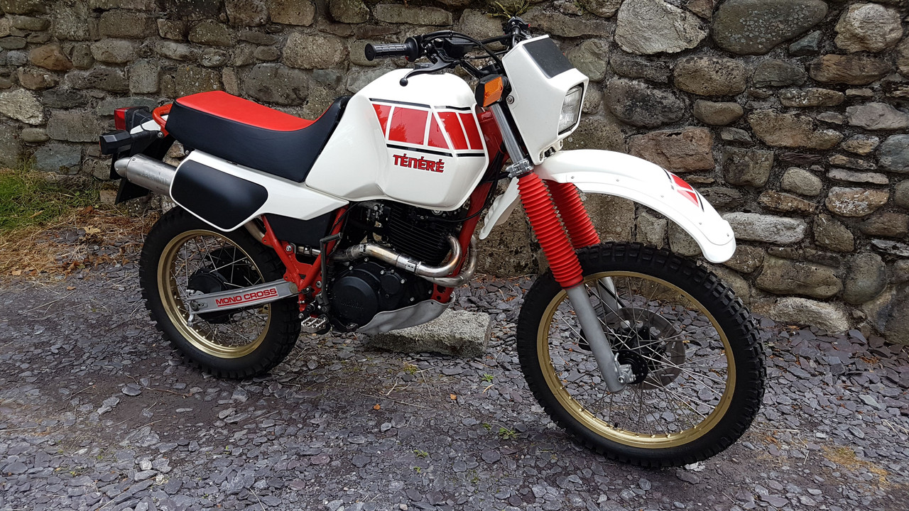

The bodywork has a story.
The picture of the original bought bike has what appears to be a correct tank. When I looked into the tank on purchase it looked to have a very thick green liner in it. After stripping the bike I found some classic bodgery. Someone had cut the bottom out of the tank and inserted a Kawasaki KX plastic tank, they'd then foam filled the gap and welded a fake bottom to the tank which looked almost original.
I managed to source a mint petrol tank from a guy in Kent who'd had it in his attic for 20 years. However the issue was he wouldn't post it, I had to collect it. Luckily I was working down there and literally walked 300 yards to pick it up from the hotel I was staying.
I've got new genuine Yamaha panels for it but she's currently running the Australian panels but genuine front mudguard.
It was painted by my friend down the road who paints everything for me.
Re: Dans 34L Tenere resto
That looks fantastico ! Am soldiering on with my 1VJ project. What headers and muffler have you got there and where from ? :tenere:
