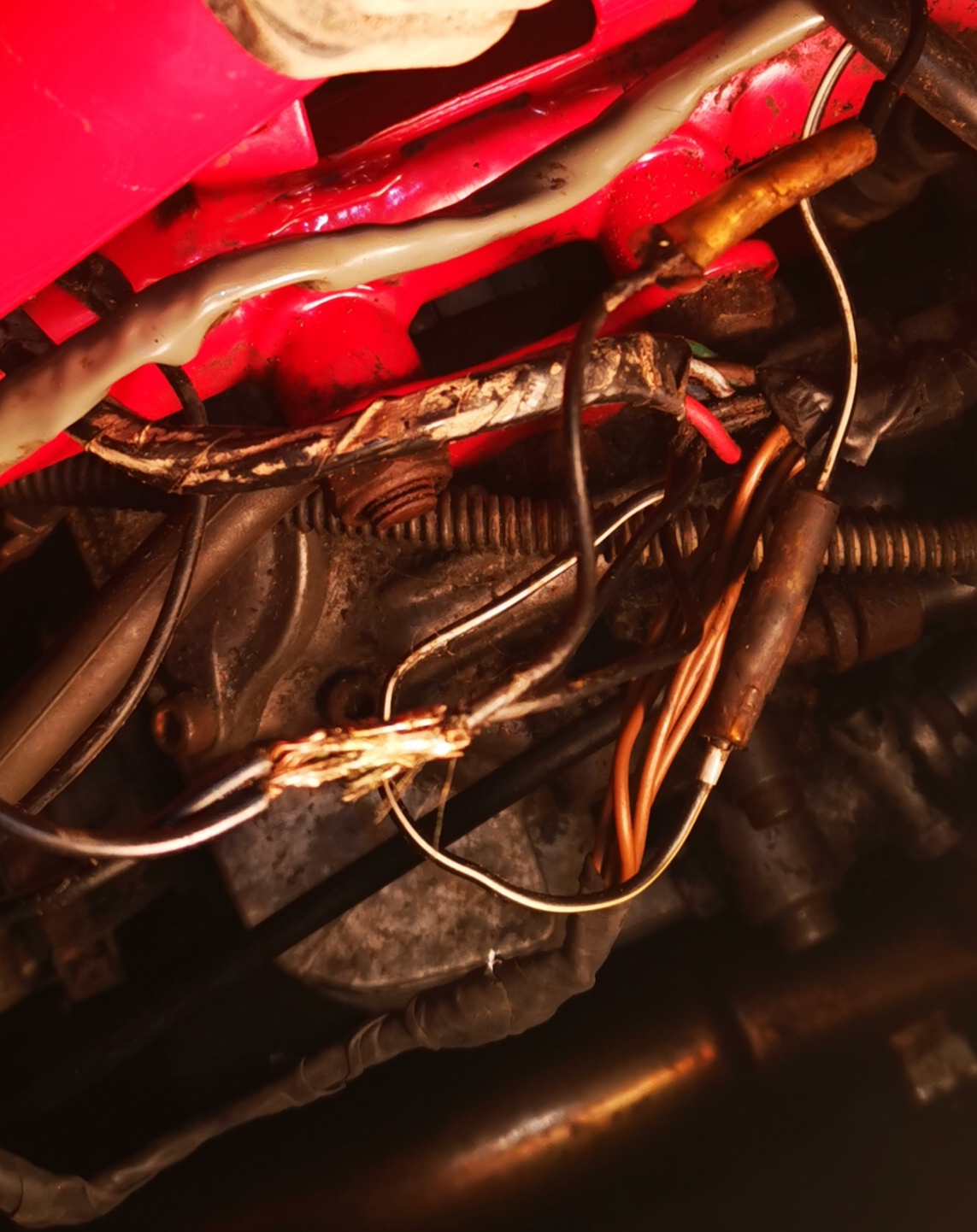

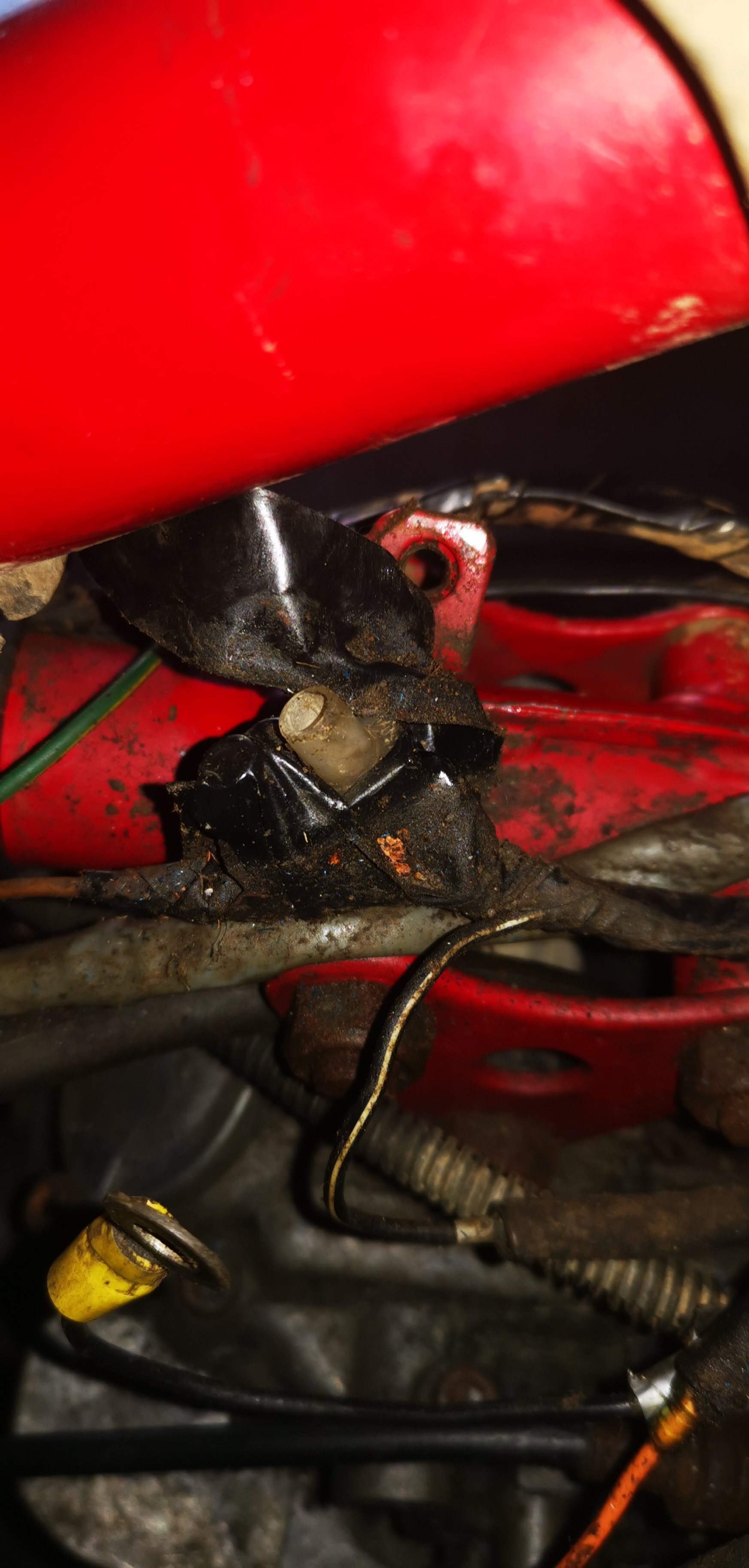

You get a idea what I'm working with with these 2 images..
One has 5 earth leads soldered together, the other had 6 brown power leads screwed into a plastic connector..

I would just bin the lot, its obvious there is a major fault & every (ahem) auto electrician has had a bodge at it.
I did have a good look & found nothing for a 34L, but i did find something that may do the trick, check your PM`s.

I recall seeing somewhere on the net someone making new looms for these but cant find it now. Might have been on FB. Will keep looking. I have repaired many a loom by totally removing and de taping the lot and replacing full wire runs. Need auto lug remover tools and replacement lugs to suit your plugs but they are easily cheaply available these days on ebay ali express etc
Re: Lights and indicators
Yep i was thinking the same thing when i replied, not sure if it was on here or FB but yeah there was someone making them.dzl wrote: Tue Jan 14, 2020 4:33 amI recall seeing somewhere on the net someone making new looms for these but cant find it now.
I had a similar experience with my 34L.
Just take the loom off, cut off the insulation with a razor or Stanley blade. Using the wiring diagram get rid of the bodgery with new wires (of the correct colour) and new connectors.
It sounds far worse than it is to actually do.
