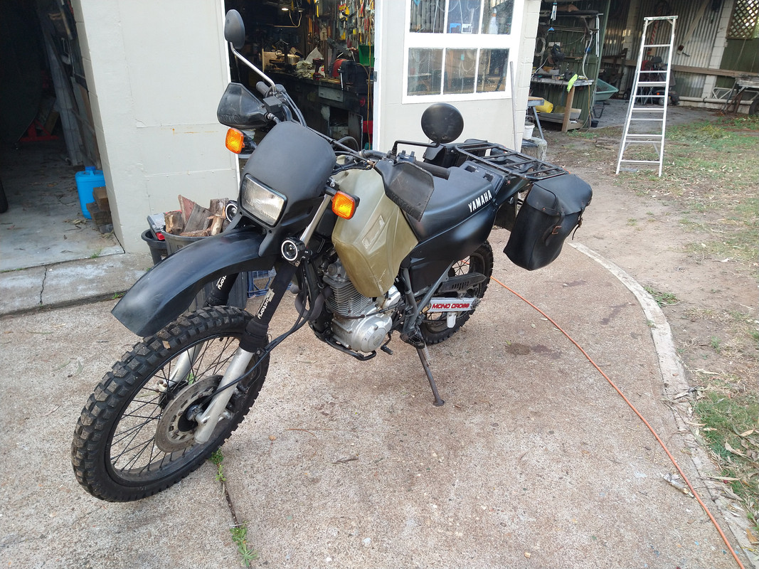

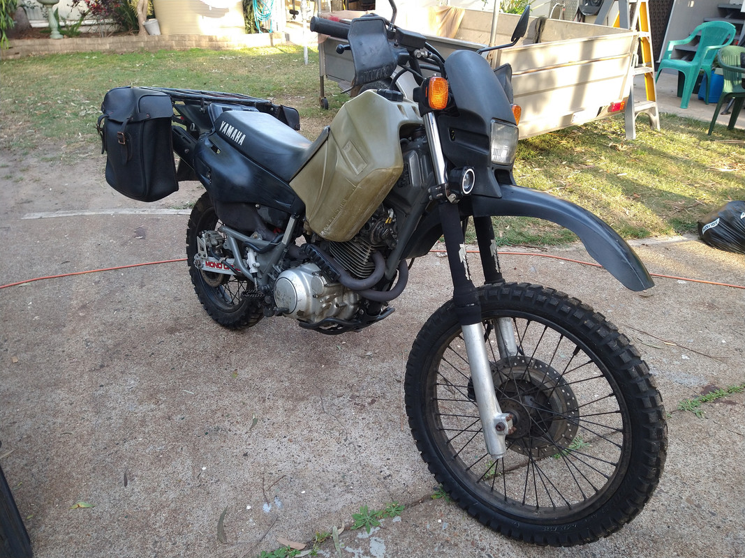

So loooong story on the ex army bike, I had stored engine parts in plastic storage boxes, brand new 5th gear, cams, ect ect anyway the shed leaked and filled up the box with water, the whole lot sat in water then slowly evaporated over a long dry summer ruining everything, so when I went back to restart the project I was pissed , salvaged what I could and just didn't want to look at it so stored it away, anyway I was given a 2001 xt600 that was almost written off, so I took a chance and fitted the motor as is and bugger me it's sweet, so hopefully get a roadworthy for the bike this week and it will be finished after 10 years I believe
