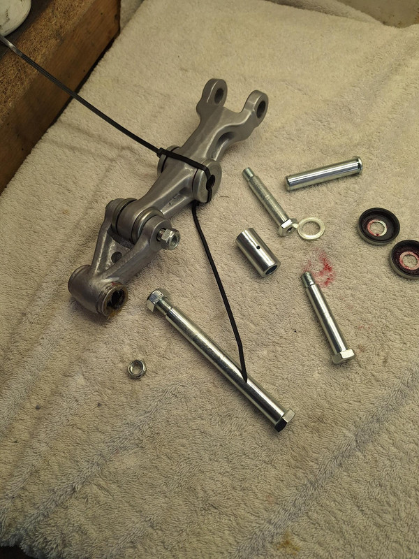

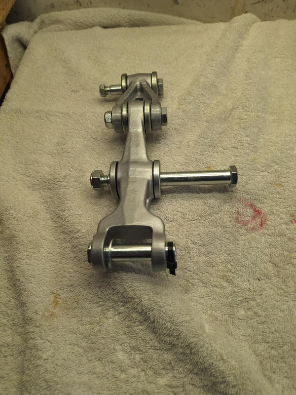

Got the linkages back together with the plated bolts and plenty of grease. The nipples will be added after build as its too easy to damage them during build, don't ask how I know.

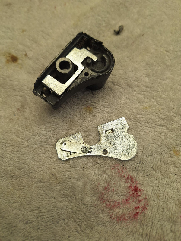

Replated the seat latch action and the rear plate

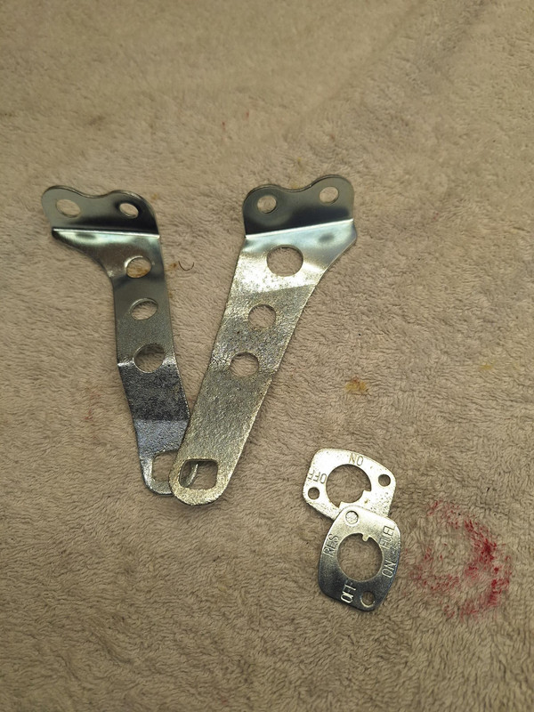

Seat stays and the plates from the petcocks:

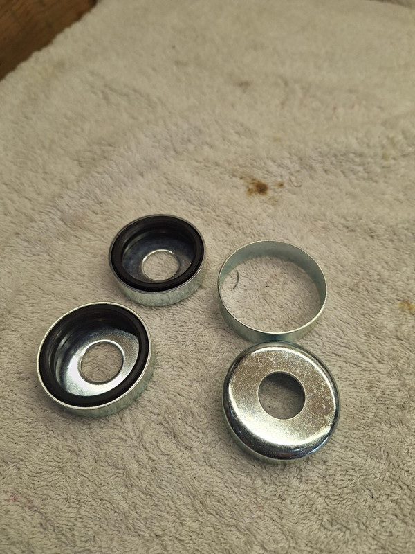

Swing arm cups, you can gently prise out the inner seal before send to re-plating for the best finish.
Got the large washers back that keep the clocks in the holder. They'd managed to lose three of the four R clips during plating, so I went stainless on the R clips.

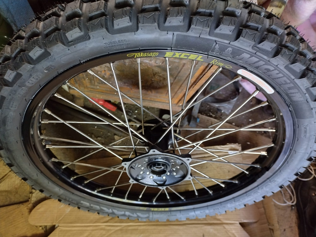

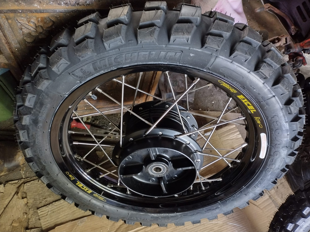

Got my wheels back from Doug, finished to his usually high standard.
With my current favourite Michelin Anakee Wilds
I go up a spoke size on the rear normally but this time the spoke supplier made a mistake on the front spokes and sent them the next size up.
So front and rear are one size up this time, it requires the hubs re-drilling so it's quite involved.

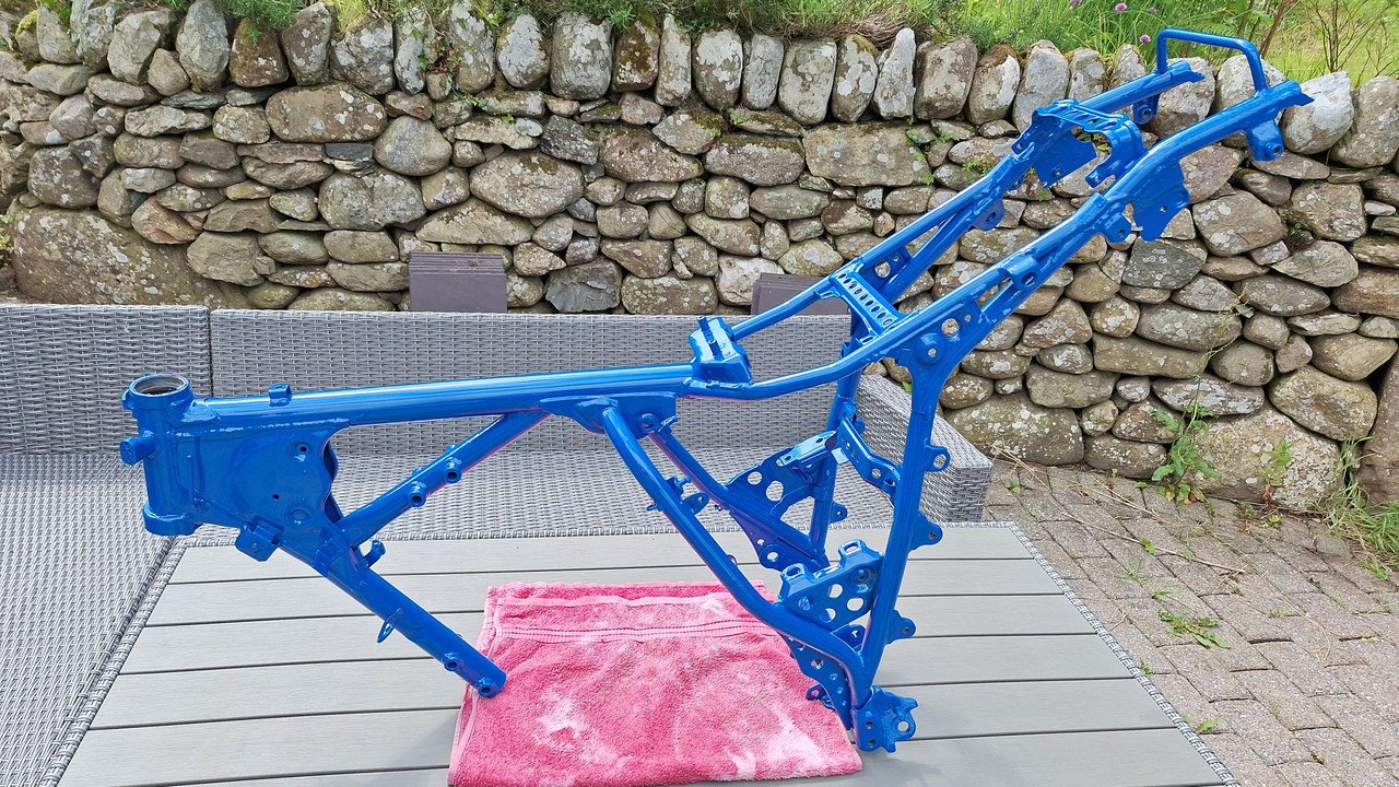

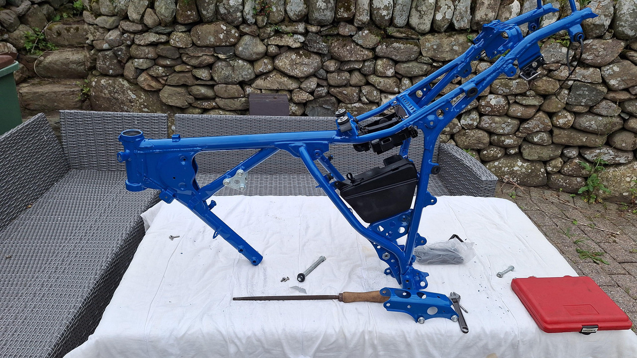

Frame refinish.

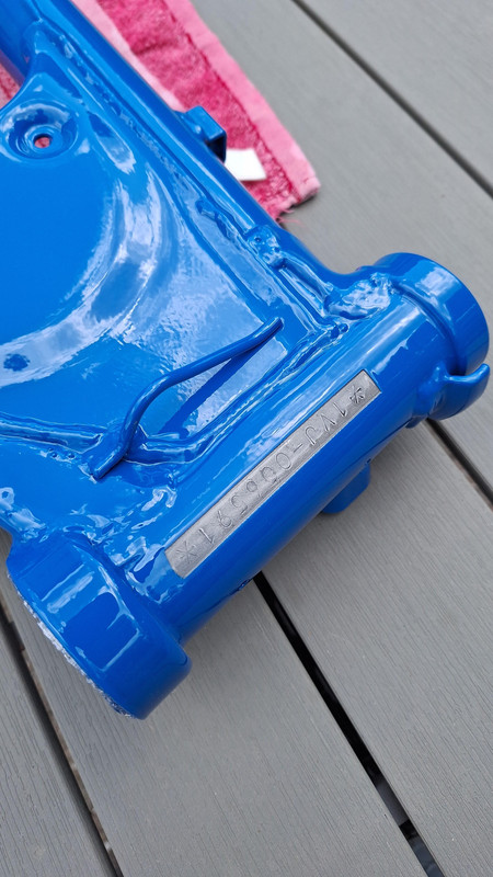

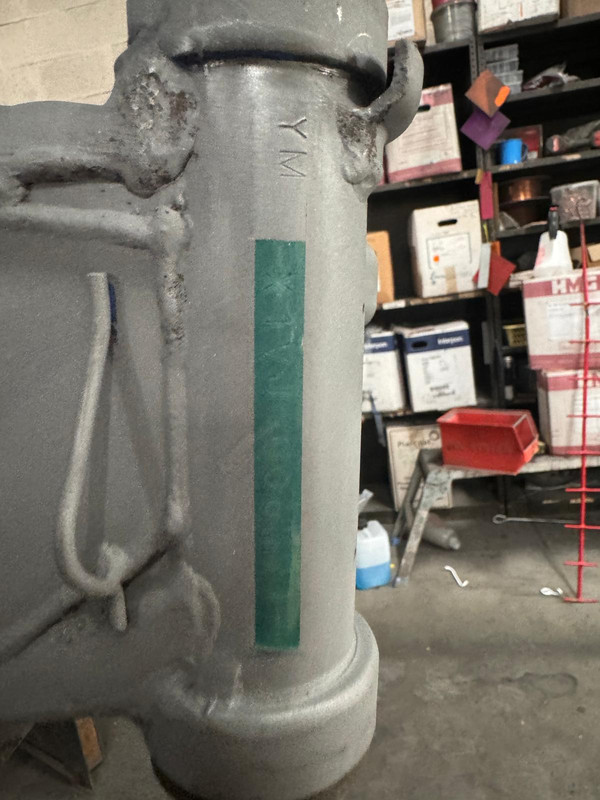

Normally I would just get the frame powder coated without worrying too much about the frame number but I'm hearing that more and more MOT stations are refusing to MOT bikes without clear numbers. I was also concerned about the blue colour but it's absolutely perfect match.
It's also been clear coated which I don't normally do but its needed when you do the frame number like that. So these photos show the prep needed just to make sure all the threads are clean and the bottom engine cradle still fits.

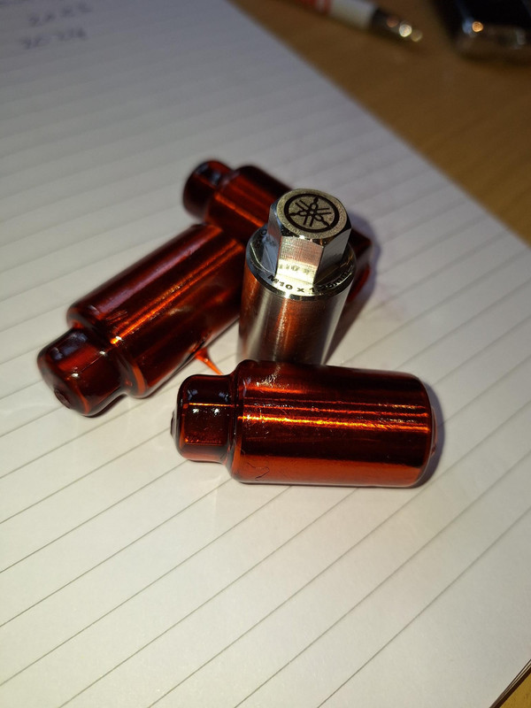

Engine barrel bolts in stainless...

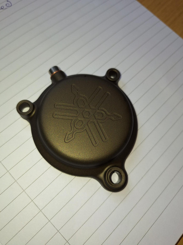

And an engraved ceramic coated oil filter cover...

There's some more photos to come, the oil tank was in nice original condition but when I mounted it on the newly finished frame it looked awful. So I got that powdered black. It needs picking up from powder coaters.
