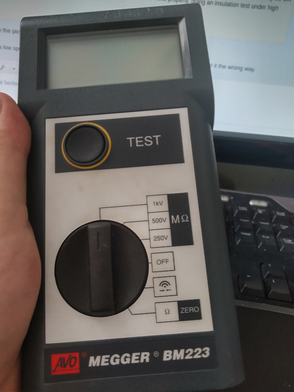

Mezo wrote: Wed Feb 12, 2020 3:42 am
motorang wrote: Wed Feb 12, 2020 2:53 amAlternator repair shops can check the coils properly, doing an insulation test under high voltage and temperature.
My Megger tests up to 1KV slywink:
That Megger looks brand new Mezo :stir:
