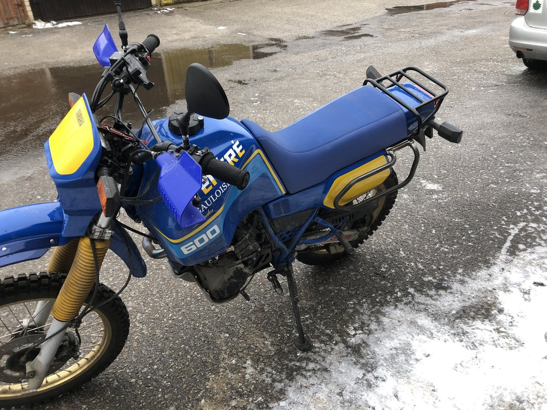

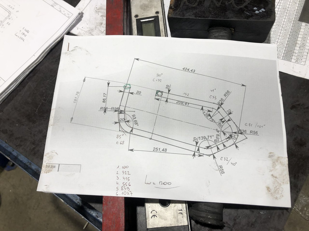

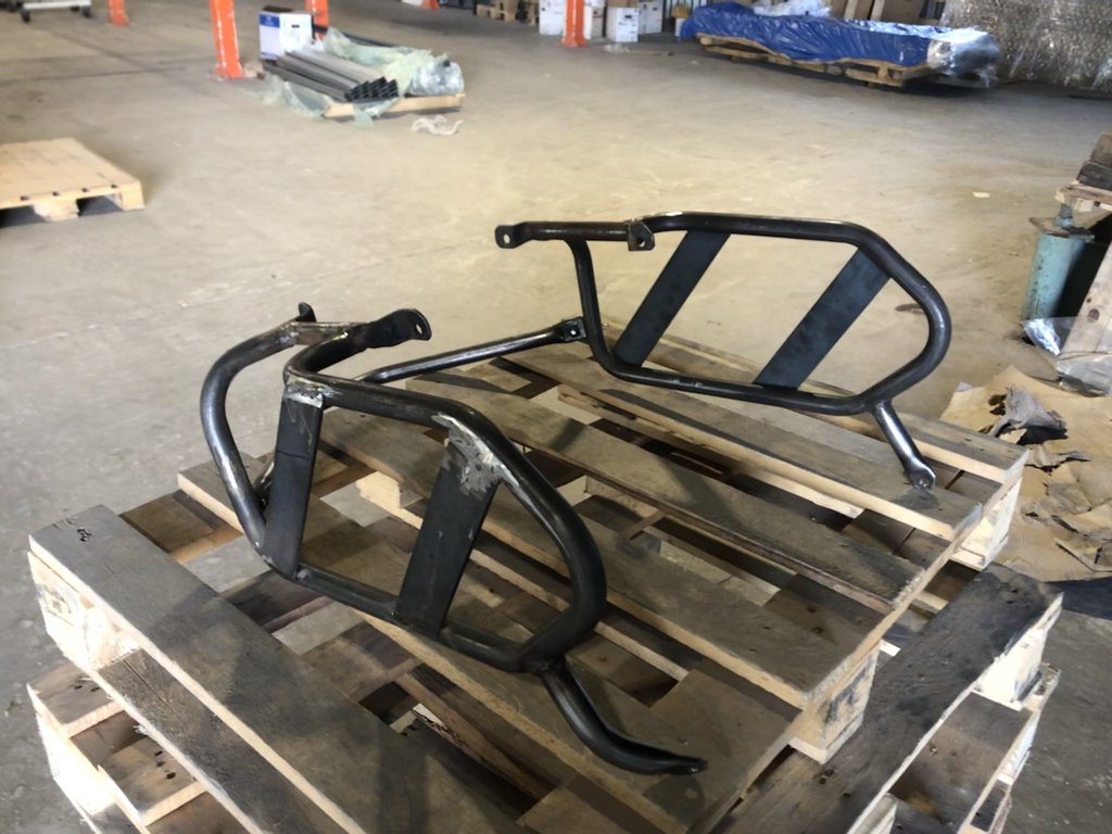

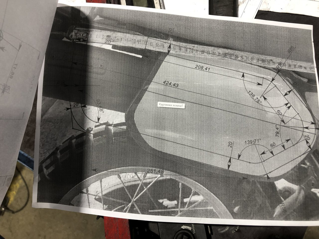

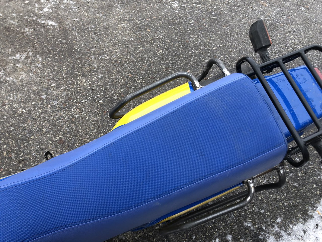

Had some time during the weekend so managed to sort out the pannier/bag rack. I made the connection point already last year, but lost the motivation as the engine failed. I had the measurements taken at a local pipe bending workshop and friday I went there with the bike to do the bending. One rack ended a bit off so I had to cut and reweld one bit, otherwise they came out pretty great. Littlebit oversized for my current saddlebag, but great if I want to use other type of bags in the future. It's still a work in progress as I want to add a connection point to passenger footpeg rack and paint them.

I would recommend having a connecting tube between the two carriers in the back, under the number plate.
This improves stability a lot and takes strain off the other points.

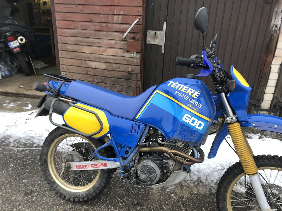

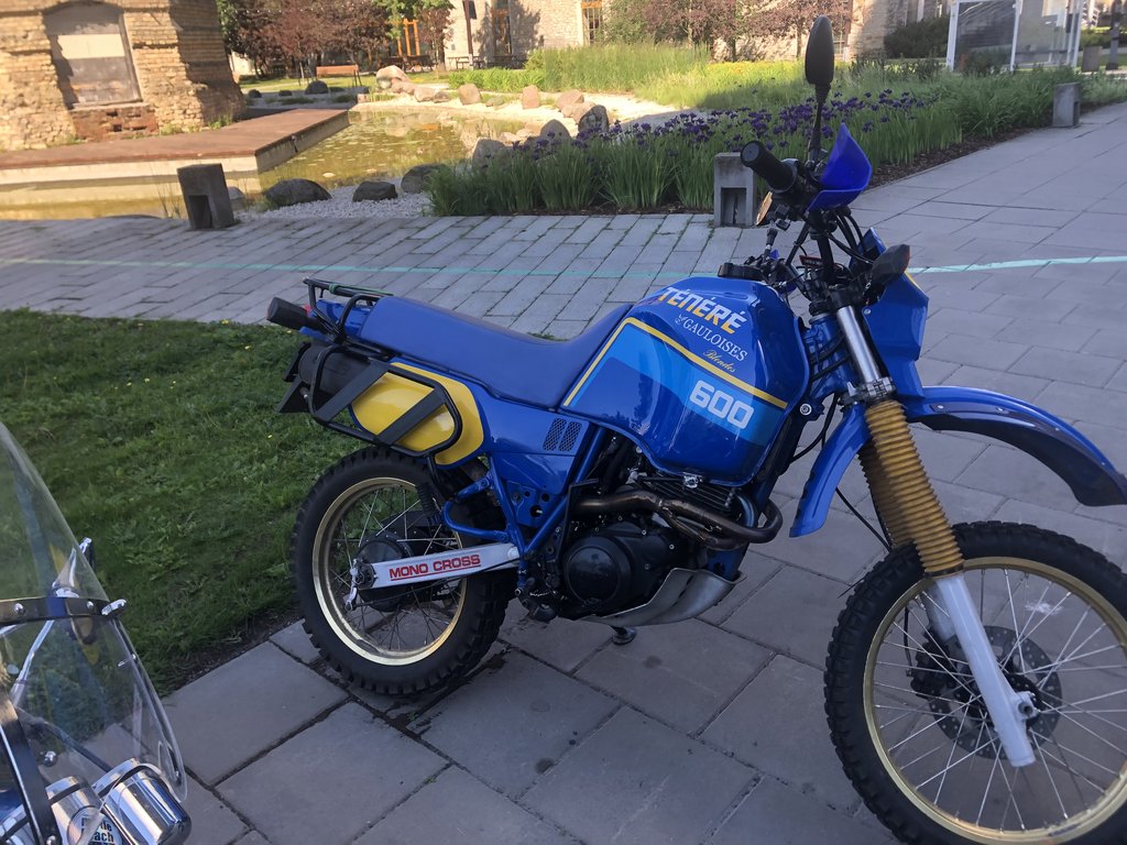

I took Motorangs advice and upgraded the carrier a bit, adding the connection tube to the back. Also another connection point to the passenger footpeg mount via a hose clamp. All together it seems really nice and sturdy now, it should be perfect to fit the Kriega OS bags.

Any updates Ott? I love your racks!
