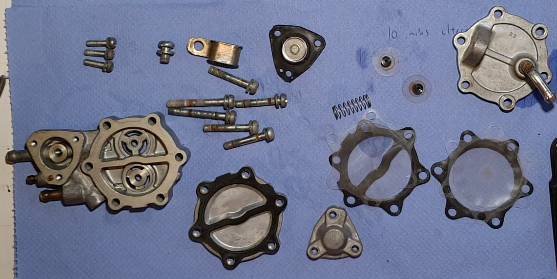

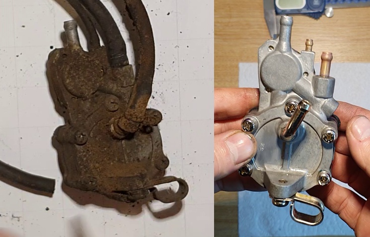

Fuel pump is today's victim. Originally covered in dust and grease. Chucked the whole thing in the ultrasonic cleaner, then couldn't help myself and pulled it apart. Pic below if you've ever wondered what's in it: two one way valves and a diaphram.

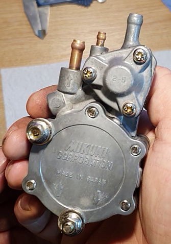

I nickel plated all the bits, including the spigot that goes to the inlet manifold. Bit tricky cleaning and plating such small bits, especially as the screws had captive spring washers. Pressed out and back in the spigot to the inlet manifold.
Nothing appeared to need replacing which is lucky as I couldn't find anything approaching a rebuild kit on t'internet.

Kits are HERE but yours looks fine, kits are known as "Mikuni Pump kit 52-82"
Re: Bazmonaut's 3AJ rebuild
Original Yamaha number for 3AJ membrane kit would be 2TY-14940-00
Usually some NOS Ebay hits will come up.
motorang wrote: Wed Apr 15, 2020 7:13 amUsually some NOS Ebay hits will come up.
True & there is one for sale in the USA for US$50.00 + US$15.00 shipping, but its still a 30 year old (NOS) membrane, the link i shared is for the same thing (brand new) & its only £24.00 in the UK (where Baz is located).
