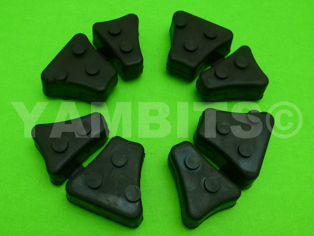

Does your bike have cush drive Scottie? could be worn out.

Now that the bike is together i checked the chain tension and it's fine. The cush drive is still good too. Hoping to pull the clutch tomorrow and measure the plate thickness. I bought a clutch kit on this trip but didn't expect to use it. Hope it's an easy fix. Fingers crossed
