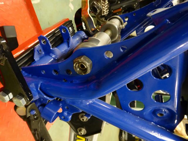

can anyone advise the length of a 3AJ swinging arm spindle?
As you can see, mine seems to be 'short' by some way.
I seem to remember that earlier frames (pre 3AJ/IVJ??) were not as wide , could this be a case of wrong part fitted?

That swingarm axle is too short, looks like its been hacksawed off :bigeek:
I dont have the measurement of the axle possibly another member has one out of the bike they could mesure?

If I get into the garage tomorrow I'll remove shock and swing arm and measure the spindle! Looks brand new so maybe wrong part supplied in error for the rebuild?

You will have to remove all that to fit the engine anyhow (the axle goes through the engine) :smiley:
