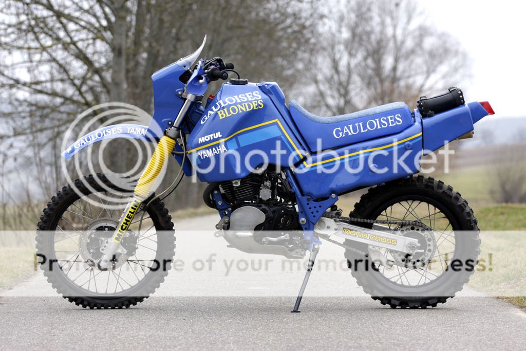

So this we wanted to change back to blue(the bike was original blue) and hopefully upgrade a bit to this dream

Still waiting for new rims and spokes- back wheel changing back to standard 18inch again and a few others but the only needle in the haystack is the yellow fork rubbers - all the colours but yellow is available -thinking of trying Suzuki for the old RM standard fork -if not to pricey and then also undecided on the sticker layout
