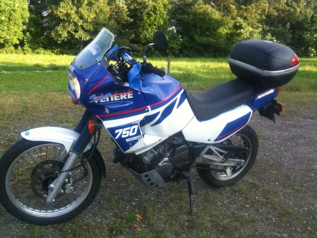

This is a picture of my Emu before the makeover started:
I love the blue Sonauto rally replica, so that’s my goal for the Emu. However I’m doing a white frame with blue paint a replica stickers (so stay tuned). Im doing the blue paint and stickering after our trip to Morocco because I’m planning to put quite some kilometers on the old Emu before the trip.. The mantra is “testing the hardware is more important than the blue paint with stickers”

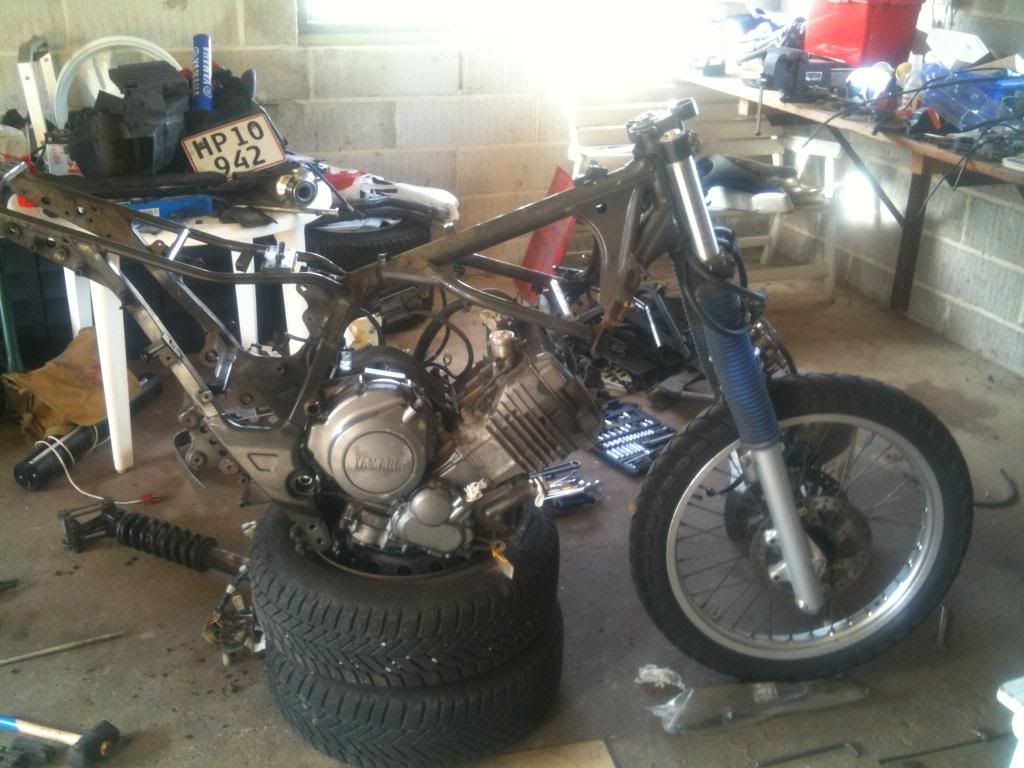

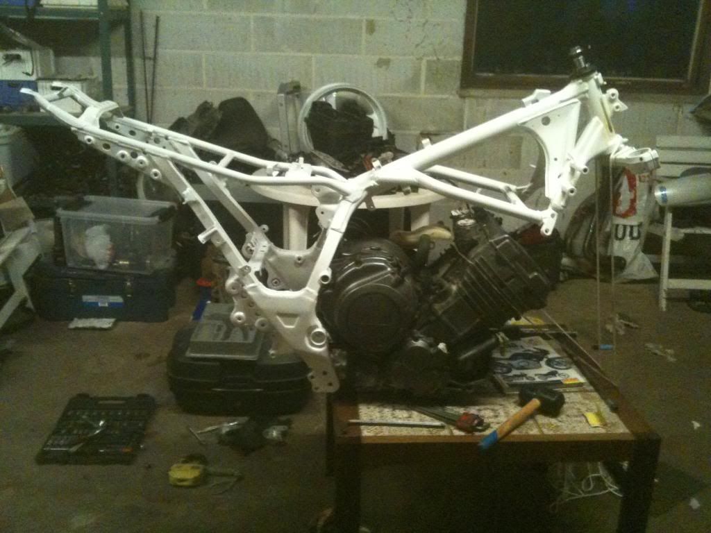

The winter 2013/2014 I dismantled the entire bike and sent the metal of for power coating + clear.
This is a few blurry pictures of the process:
As you can see i'm a pretty organiced. everything has its own place and my garage is as clean as a operating room at a hospital
When I picked up the parts from the painter I was a happy camper. It’s fantastic to see how a sanding and new paint can turn old metal into new looking parts.

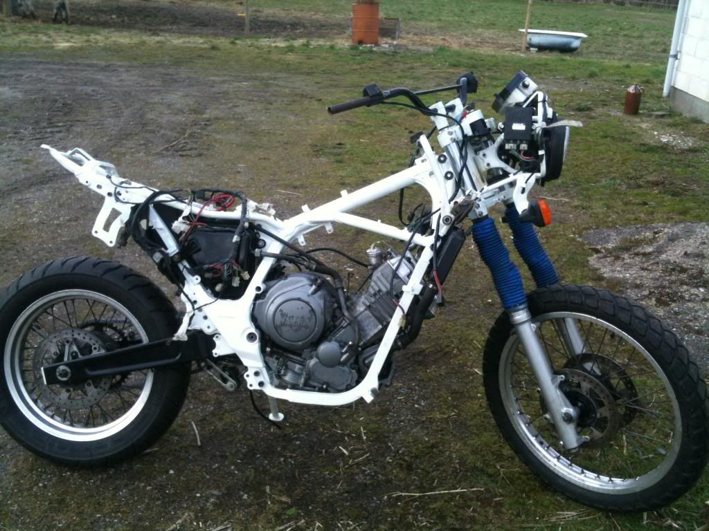

Here is a few picture of the Emu in its current “glory”:
Getting the engine back into the frame after a few months is just wonderful

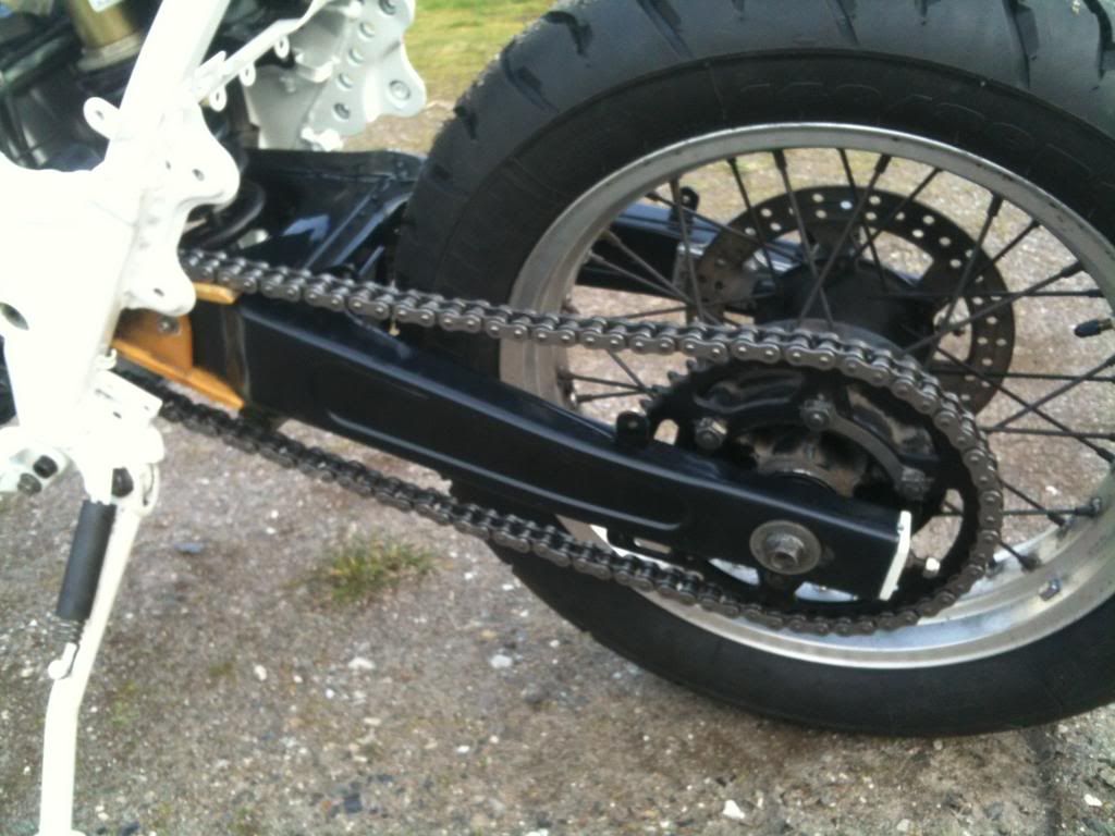

The newly painted swingarm with new bearings and girly tarmac tire (Anakee 3)

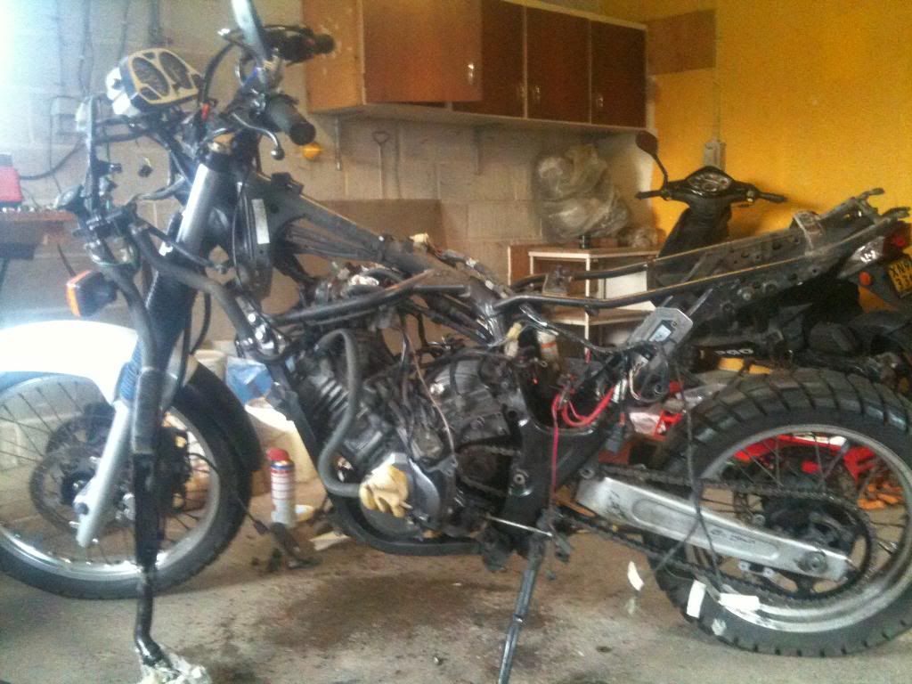

The oil tank, cooler, speedo is mounted, but the wiring harnes is still not sorted out:
This is the current progress of the bike.. A lot of work is still in front of me
