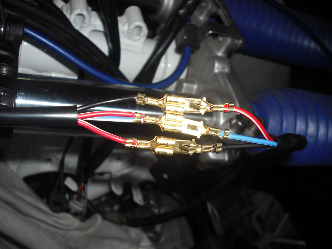

Attempting to make 1 ignition switch out of several :lol:
Anyone wanting to fit the later r/h handlebar switch to their Tenere... this is how you wire them, although the wires are the same colours, you don't join them colour for colour as the switches are different... the wiring on the left shows the new switch, one of the red/white wires has to be joined to the blue/white then connected to the blue/white on the existing bike wiring.
