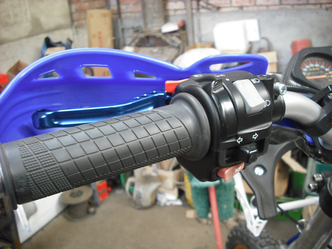

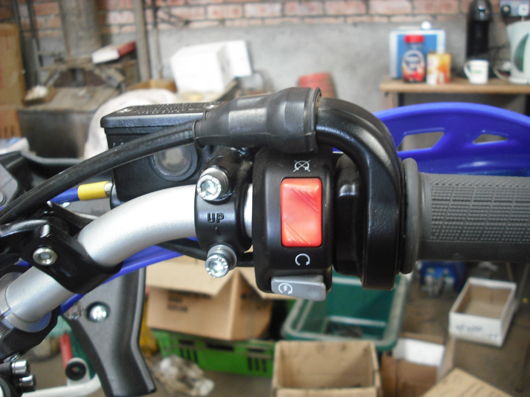

Hi Scotty... I always use later switches now, they're much better.. all the wires are the same colours but you'll have to change the plugs....
XT600E, XT660's, Super Tenere's… I've even used switches off TDM's … tons of them will fit
My current rebuild
Left switch XT600E
Right switch is off an early R1
